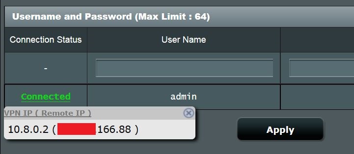

Hi John,
Just noticed something in the Web Gui under the VPN option. Not sure if this is correct or not. In the VPN status tab it shows the user connected and all the info associated with that connection. However under the VPN Server tab it shows the same user as disconnected. See below for visual. Thanks John
Hi John,
That'd be normal if you don't use user/password-based authentication but strictly certificate-based authentication.
I'm currently using username/password authentication only if that helps with the Auth. only option set to NO..nothing fancy. See below. Thanks very much.

What happens if you define another username other than 'admin' and connect with that?
Hi John,
Same issue occurs whether you use the admin account or an account created manually. VPN works fine it's the visual on that page that is incorrect. Thank you.

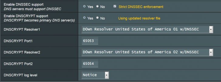

@john9527 , you're U.S. based. What DNS Crypt resolvers do you use? I am thinking about setting up DNS Crypt this weekend.
Here's the settings I use. I throw everything on to make sure it all works :)
Start out withe the Strict DNSSEC enforcement unchecked....then after you have it working you can check it (with that checked, if you inadvertently use a non-DNSSEC enabled server, you'll lose intenet access since all DNS replies will be rejected)
Awesome, thanks.
Well, I am going to go a slightly different route. I will be trying to set it up on my pi-hole instead of the router itself (since I have those "alien martian packets" and the issue with DNS on OpenVPN because of pi-hole). Just wanted to know what servers you were using since I also am state side.
