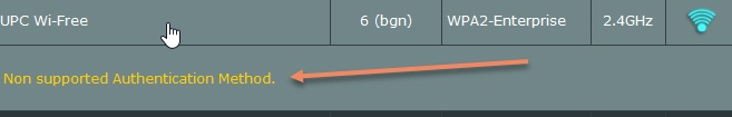

Hi Everybody, maybe you Gays add function AP Repeater 802.1x with EAP-PEAP-mschapv2 authorization.
In Europe big ISP (“UPC” his name) have many free access point in Europe. But ASUS firmware not support EAP AP. Maybe in this fork you have attach EAP for access. Please help!
