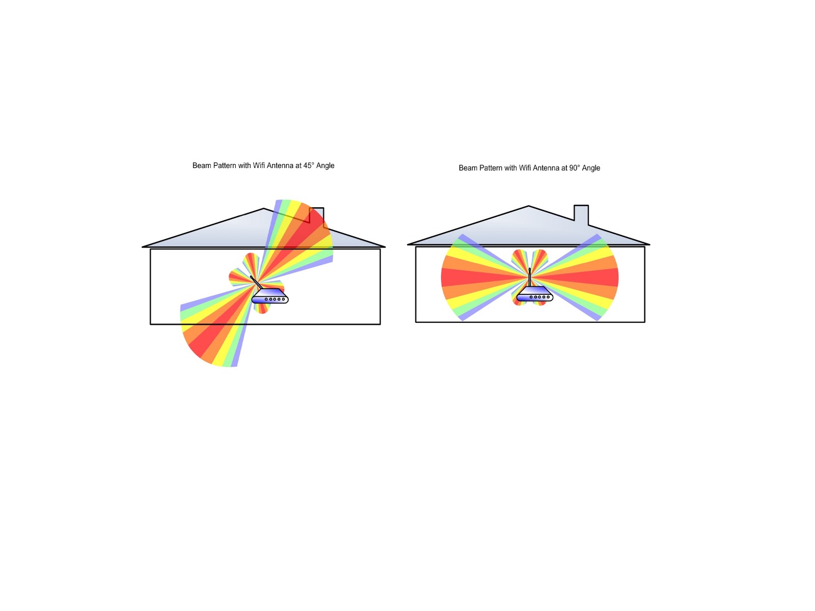

Here's a diagram you might find informative. Tilting the antenna slightly TOWARD a target device usually helps.
In case you're wondering, the government imposed a law requiring WiFi device manufacturers to introduce methods to prevents users from boosting transmit power, because of some law against it which previously had no teeth. Long story short, Asus removed this featured ability, long ago. So, we're stuck tinkering with the antenna gain, instead. Fortunately, beam-forming kinda helps:

i tried changing angles of the antennas. I see that all my 2.4ghz signal is very strong and signal strength for 5ghz dint improved anything. Only issue is with ipad and iphone. ipad and iphone are getting very weak signal. i tried disconnecting them and reconnecting back. Samsung phone is same location os getting very strong signal
