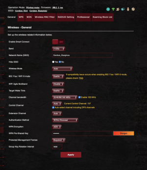

I am pretty sure that the general log is unchanged. The only change I made to the router was to upgrade the firmware to latest Merlin 388.2.2 ROG version. I attached my wifi setup page. Two differences I see are (1) I have auto select channel including DFS checked, and ColDen does not; and (2) I enable target wake time, and ColDen disabled (I have no idea what that does).

@pgershon Your screenshot shows you using channel 157 but in your initial post it was trying to use channel 100. Have the messages in the log now changed?
The last message I got said 100/160, just like all the others. Not sure why the difference.
