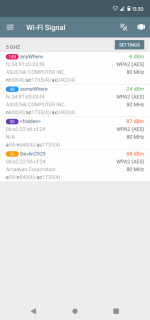

I just bought a brand new GT-AX11000 (A1.1) Canadian version and everything works fine, except 5GHz-1 (lower band) is significantly weaker than 5GHz-2 (upper band). I have tried all configurations that I can think of but 5GHz-1 is consistently 15-20dBm weaker at any distance (Windows laptops or Android devices). To make sure it's not the interference from my neighbours, I put my phone right on top of the router and there is a 18dBm difference as shown in the screenshot. I have tried the latest official and Merlin FW with identical results. I have found a thread where 5 owners shared the same experience but wonder why, especially when there are other GT-AX11000 owners said their 5GHz-1 is actually stronger than 5GHz-2.
Also, there is no 160MHz option for 5GHz-2. Is it a Canadian thing? Thanks in advance.

It's all due to the Canadian spectrum laws.
This website has the power limits on each band. 36-48 are limited to 200mW, 5 times lower than 149-165. So it`s normal that 5G1 is weaker than 5G2 149-165. Now, on the bright side, 52-64 has a much higher EIRP than 36-48. So, if you're using 80MHz bandwidths, it might be the better 5G1 option, but with the DFS inconvenience.
As for 160MHz, Canada only has one options in the 5GHz spectrum: 36-64.
