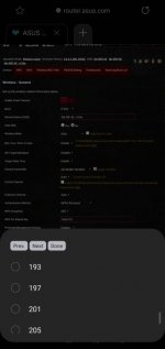

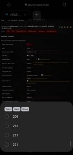

I tried to test the signal strength for the 80MHz wide channels, however something seems off. The router list 48 20MHz wide channels, but only 12 80MHz channels which are all off center. I thought there were supposed to be 59 20 MHZ channels and 14 80 MHz channels.

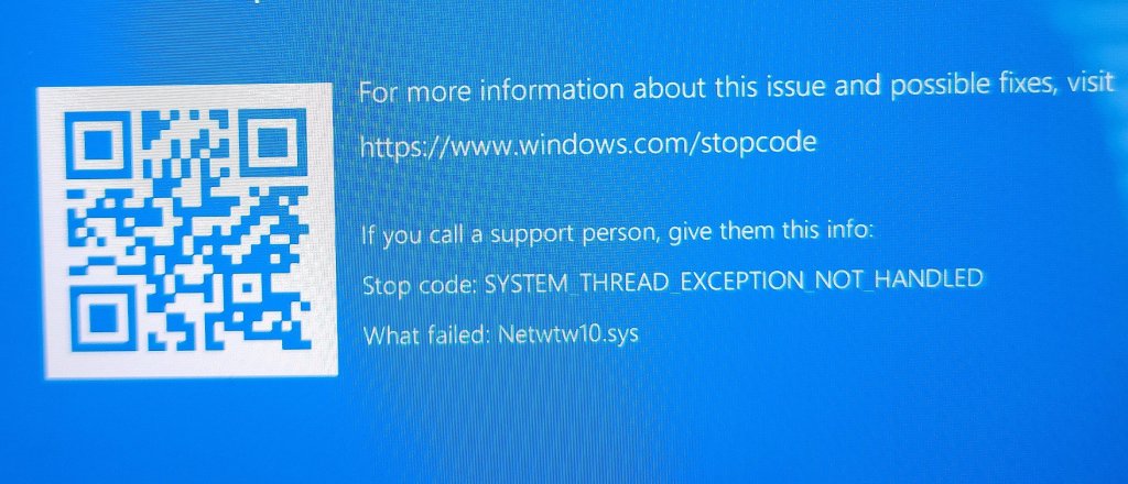

Also started to get this BSOD this morning. So much work still needs to be done in regards to drivers and firmware but I’ve got a month to experiment.
The reason why you only see 12 channels because you have PSC (Preferred Scanning Channel) enabled. If you turn it off, you will see more channels. Like this.
Keep in mind if you do that, you may see lag spikes more often as the STA goes off channel to scan. The PSC are purposely spaced at 80 MHz intervals to coincide with the minimum bandwidth most devices will use.
The AP should be supporting channel advertisement in 2.4 and 5 GHz and the STA should be looking there for channel info.
