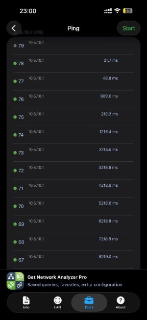

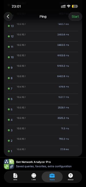

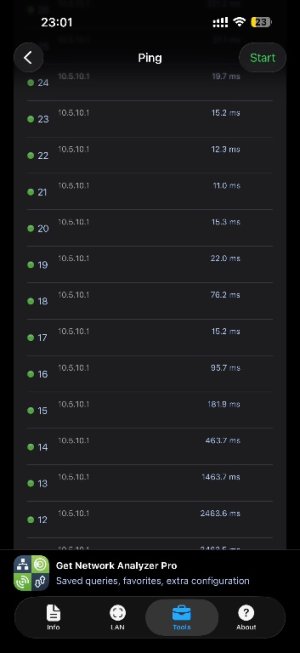

Symptoms :
  • Ping to the router itself (10.5.10.1) from any device on 2.4 GHz: average 200–400 ms, peaks up to 2–4 seconds, frequent packet loss (3–19% depending on the test, e.g. avg 88 ms but still peaks at 2614 ms and losses).
  • All home automation (IoT) devices are affected: command execution delays of several seconds to over 10 s, commands stuck on "executing…" or timeout, random disconnections.

I did another test this morning while connected to the AiMesh node on 2.4 GHz, and I pinged the main router :
I’ve already submitted a support ticket to ASUS, but if anyone has additional ideas or suggestions in the meantime, I’d greatly appreciate it. Thank you all for your help!
