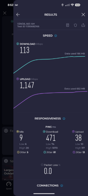

I have been encountering a perplexing issue with wifi 7 devices connected to my GT-BE19000AI. I have the latest firmware installed, AFC enabled, and QOS disabled, but starting yesterday after my google fiber install I began experiencing severely reduced speed and lag with my wifi 7 devices. I'm lucky to get 300Mbps with a 3 gig Google Fiber connection standing next to the router with a 320 MHz Intel BE200 card device. If i force the 6ghz channel bandwidth to 160 MHz, my speeds improve to nearly the max allowed for that bandwidth.
For example the day before I was getting download speed of 905.99 Mbps, the max my old 1 gig AT&T fiber would allow, after the google install and router firmware update I'm only pulling 447.04 Mbps. Wired speeds are fantastic. At 160 MHz, I'm pulling 1,506.94 Mbps.
Any ideas on what could be going on?
I performed a factory reset and rolled back the driver to the previous release, but the problem persisted.
