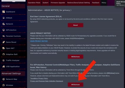

By any chance did you accept the license for AiProtection or AiCloud or similar ? If you did, disable the features and reject the license.You have to do both. A factory reset wouldn't hurt after doing that.

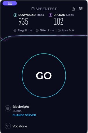

Random test. It just can't go any faster because of my 1Gb connection. But here you go. More than 650 for sure. BTW - I am getting the same result while testing with a cable. The device I did the test on is Wi-Fi 6E capable, not Wi-Fi 7.

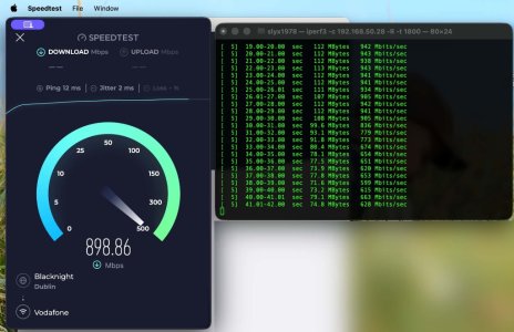

Here is another test I just ran. At the same time, I ran Speedtest and iperf (download from the NAS). As you can see, the speed I am getting is 898 + 628 = 1,526 Mbit/sec at the very moment the screenshot was taken. Again, Wi-Fi 6E. One wall between the laptop and the router. More than double the speeds you are getting.
How to reject the license?
