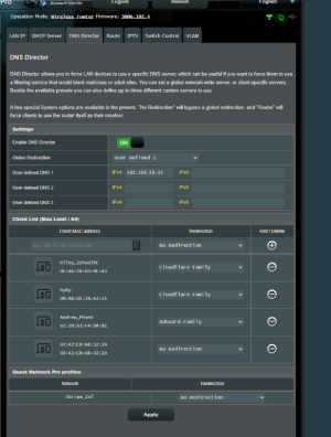

@VeloxNEx, how exactly is the full DNS page configured? It may help if you post a readable screen shot of the DNS Director.
I made a post a while back on how to setup DNS Director to use Pi-Hole. See the following post.
In my case I have configured the User Defined 1 with the Pi-Hole IP address. The Pi-Hole(s) are set in the Client List and configured for No Redirection. I have further configured the LAN DHCP DNS server fields for the Pi-Hole IP addresses. Everything seems to be working correctly on a RT-AX86U Pro running 301.102.4.

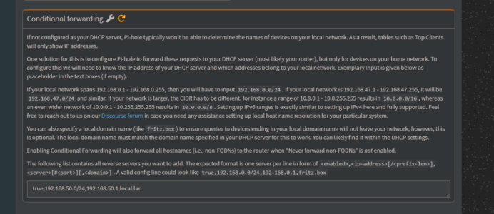

I've seen your posts around when I've googled this issue the past few days! Attached are my screenshots. I'd be more than happy to have overlooked something silly. As soon as I logged into the router and saw the iptables, I'm worried it a bigger issue or something else is going on.
I know you didn't mention any specific pihole settings, is there anything I need to setup on that side?
But small list:
Upstream DNS Servers - cloudflare
Advanced DNS Settings - NEver forward reverse lookups for private ip ranges
Conditional frowarding - mine is a string - attached
Your conditional forwarding specifies the domain “local.lan” but it looks like you have not specified any local domain on the router’s DHCP page.

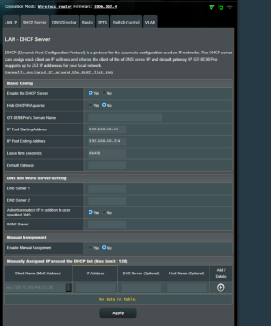

Also, why not put 192.168.50.42 in the LAN DHCP DNS1 field so devices query Pi-Hole directly, instead of needing to be redirected.
Thanks for pointing that out! I'm not sure that matters, but I can fix that local domain part pretty easily.
The reason I haven't really done that, is becaues the DNS Director is active because I have kiddos. They vary in ages and I use the built in router family filtering for different ages. So the DNS Director remains active because of that. I need it to play nice and work correctly. When I google adding the pihole to the network with the latest years (2023 - 2025) I find posts like

I "can" add the LAN DNS server, yes. But it was "funny". I guess I can play around with the DNS Director settings to get this to work. I suppose the global settings would be no redirection by default instead of Router? Then not to advertise the router's info with the DNS.
