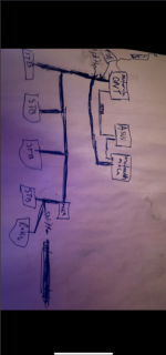

My network layout. Apologies for the late reply. Darker lines are cable lines and thin line is ethernet
Clearly, you have no idea how to set up or manage a secure home network. My guess is that a Verizon rep sold you a bill of goods when they sold you the MOCA units.
Your system should be: ONT--Asus Router--MOCA--MOCA--Ethernet. Other Ethernet off of the router.
My read is that if you connect the MOCA to the ONT then connect an Ethernet device you will by-pass the firewall. which is not a good idea.

What's the deal with the MOCA connected to the ONT and the Asus and nothing else? What's its purpose? It just looks like a loop.
The diagram suggests there is just one run of coax and a ton of splitters. Is that how your network is wired?

The first moca is what supplies internet to the stb. Such as guide on demand apps etc. I can draw a better diagram but watch the video. It’s literally the same thing besides the 3 way splitter he uses - I only use a 2 way.
the other moca is just Bc I wanted my Roku ultra hardwired.
my entire house is hardwired w cable so I used the existing cabling to take advantage of that. Make sense ?

The video does help, what’s unclear to me is if there is a filter on the coax line going back to the ONT, or else your lan could be exposed.
The coax line going to the TV boxes from the ONT provides the broadcast channels only and no internet service. To provide on demand services via the internet the Verizon boxes use networking via the moca connection. This is very convoluted.

OK i can take out the POE filter. I wasnt sure where it should be. so THANK you,
