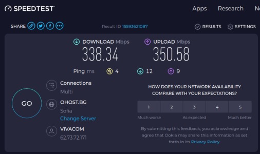

I got the ASUS RT-AX86U Pro on a Black Friday for a good deal - 171,45 €. It arrived a few days ago and I was pretty excited to test it, because I was using a 10 yo Cisco Linksys WiFi N router, which had been working with no issues, but I wanted a faster one, because I upgraded my Internet to 600 Mbs. Anyway, First tests were impressive (see attached screen shot). I made the initial setup with the phone app. But then something very strange happeed. After the first 15 - 20 min., I started getting very poor and unstable connection. Like, I'm in the same room 1 meter from the router with my laptop with clear vision and it drops the connection. Phone - too. The other laptop - too. I can barely connect and it drops from time to time. I tried many many things, resetting it a few times, rebooting it, rebooting the laptop, the phone, changing some settings I discovered in online forums, "forgetting" the networks in the phone and lapto and so on - nothing. I tried disabling beam forming, QoS, splitting the 2.4 and 5Ghz SSIDs into two separate or in one name, disabled all kinds of settings which were supposed to help, but the router was practically useless! I tried with the latest beta firmware - same thing. I didn't try with Merlin, because I was going to return that PoS immediately to Amazon the next day. I even printed the label fro returning it with HDL. I went to sleep, but the router was in the same room but the LED indicators of the router were preventing me to fall asleep so I unplugged it straight from the power outlet.
The next day I was packing it already but remembered that I need to reset it once again so that my personal settings aren't there. I powered it on again just to reset it. I thought maybe I should reset it by holding the "reset" pin button for about 10 seconds and call it a day, but then I decided to try to connect to it once again and do the resetting from the web UI. And miracle happened! Without changing anything over night the router was just working perfectly. It's been behaving good for 3 days now. Nevertheless, I installed Merlin on it not because it's not working, but just for fun. It's OK, still. Just to be save I reset to factory defaults once again and it's working perfectly - strong signals and great speed - just like the first 15-20 min. after I turned it on. I did not change absolutely anything in the settings besides opting for separate names of the 2.4 and 5Ghz networks.
I really hate when this happens. Now I don't know if I should expect that to happen sometime again in the future. I have one month to decide if I want to return it. I searched for alternatives and was wondering about returning it and getting the AX 88U Pro or TP-Link Archer AXE300. I really don't care too much about 6e. I have very few IoT at home (appartment). I don't care about mesh, etc. I only want a single WiFi blaster at the center of my apartment.

I am concerned with the speeds in your screenshot though. Is that with your handheld/mobile device? The router should easily be able to give you your maximum ISP speeds on a laptop PC in Performance mode and/or while it is plugged into AC power.

@L&LD , you are completely right about the speeds shown in my previous screen shot. I was so baffled by the big numbers that I didn't even notice that they should, in fact, be higher, because My ISP plan is 600 Mbs. Previously I was maxing out my WiFi N at around 50 Mbps and when I saw the triple digits I was happy :) Now, I made a new test - see the new attached screen shot, it is what it's supposed to be.
* UPDATE: So, those mediocre speeds in my previous screen shot were from the very beginning of setting up the router. Appears it wasn't actually functioning properly from the very start.

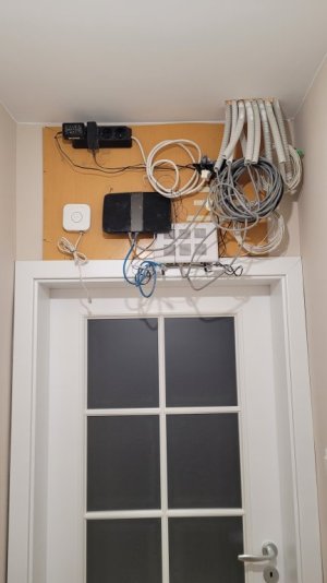

My ISP gives me fiber to the home (FTTH). Since my router doesn't have an SFP port, the ISP has given me (for free) their device, which is also some kind of 3-in-1 1) router; 2) LAN switch; 3) AP, but I have disabled its WiFi and have plugged my wifi router to one of its LAN ports. I think those ports are 1G max, not sure, have to check. Maybe if I upgrade my Internet plan, they will provide me with another device - who knows, or a media converter, but I don't know if those have multiGig LAN ports.

Yes, those speeds are much better.

Yes, when your ISP offers you higher bandwidth, they will supply an ONT with appropriate 2.5GbE ports or higher, or other methods to get those speeds.

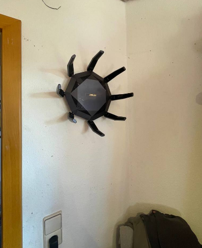

I also like the RT-AX88U Pro for another bizarre reason. I am a little bit OCD so I don't really like the standing figure of the AX86U, because it will be kept in a cupboard near the ceiling. That cupboard is not yet made, I will order it from a carpenter. But the space from above the door to the ceiling is not too much and I'd like that cupboard to have one shelf splitting it into two compartments - lower and higher. I plan to use the higher one some day for maybe some Synology NAS or smt. else. If I put the tall AX86U router with its antennas pointing up (which is recommended), I won't have room for the shelf. On the other hand, AX88U Pro has a big footprint of its own. Yeah, I am that kind of person - these things matter to me. :) Currently it's rat's nest, but we had a big renovation going on. (or maybe there won't be a middle shelf - I'm not sure, I guess it's too small anyway)

I wouldn't recommend mounting a router on the wall. A metre away (from all sides in 3D) minimum. Make that (single) shelf deep! Don't box in the router and your future options with another (middle) shelf.
To hide that 'nest, effectively, you just need some fabric/print and/or poster. See Raquel Welch's poster... Shawshank Redemption. :)
