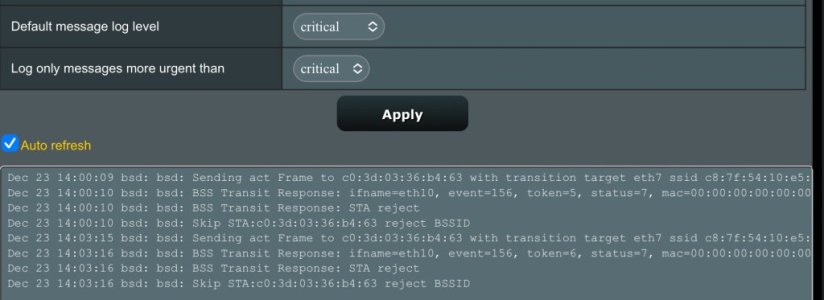

Log level : critical
log is full of BSD messages (smartconnect?)
I would like to disable this log writing.
I want to reduce the write load of JFFS.

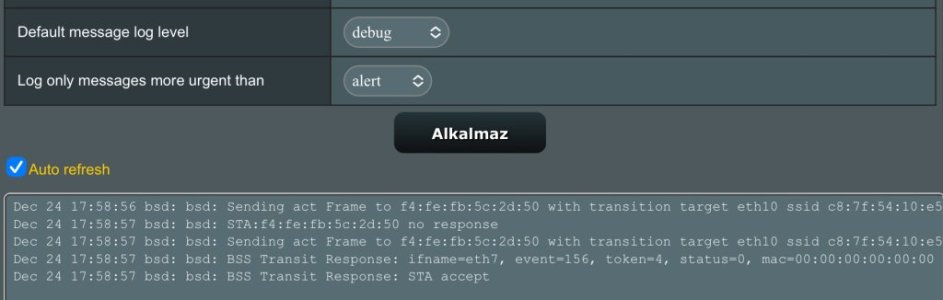

Still won't affect the nand via JFFS writes, but glad you found info you deem valuable.
unfortunately it doesn't work. :( :(
Don't know what all you've tried, but I see "debug" visible in that second thumbnail. Debug is generally quite verbose.
