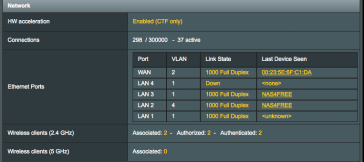

Hi AtAM1
Sorry to dive into your thread on this but it is the one that has given me the most understanding and success so far.

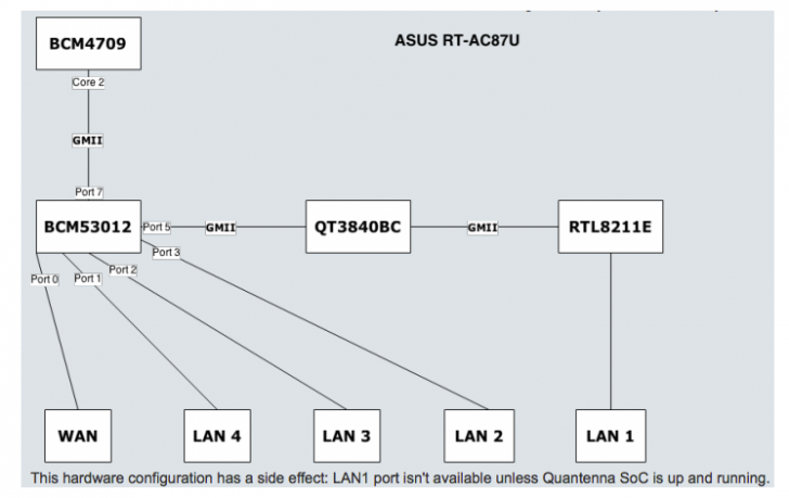

I'm trying to get LAGG working on my AC87U to connect to my twin NIC Nas4Free box.
After a LOT of reading up from various places I found this diagram:
which started me trying to understand the architecture of my overly complex ac87u, or so I thought...
Anyway armed with this I tried making some changes to your initial steps:
nvram set vlan1ports="1 5 7*”
nvram set vlan2ports="0 7u"
nvram set vlan3ports=“2 7t"
nvram set vlan4ports=“3 7t"
nvram set port5vlans="1 2 3 5 16"
nvram set port0vlans="2"
nvram set port1vlans="1"
nvram set port2vlans=“3”
nvram set port3vlans=“4”
nvram set port4vlans=“1”
nvram set vlan1hwname=et1
nvram set vlan2hwname=et1
nvram set vlan3hwname=et1
nvram set vlan4hwname=et1
nvram commit
My thinking here was to avoid ports 1 and 4 as I'd read a lot of people having problems trying to do anything out of the ordinary with them.
Therefore I attached my Nas4Free to physical lan ports 2 & 3.
I thought the results were promising at this point:
although the vlan associations fo Lan2 and 3 weren't as I expected they both seemed to be connected to my Mas4Free, so.....
I soldiered on following what I thought were appropriate versions of your next steps to see what happened.
Unfortunately the result was not great:
(please see follow up next post as only able to attach 2 files each)
The result being this:
Therefore I've scp copied the firewall-start and services-start scripts off the jffs partition for safe keeping before deleting them and now I'm back to the previous set up, as I reckon the problem with the vlans needs fixing first.
Could you please offer me any advice as to where I've gone wrong here?
Many thanks!
