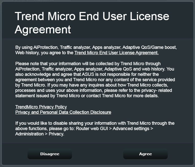

Very strange. I've never found any of those options to be enabled after a factory reset. It would make no sense for them to be enabled because you have to accept the licence agreement before you can use them. If you're not seeing that agreement it would imply that your factory reset didn't work.

You'll know about it. It displays the data collection agreement screen first.
Right... but a user could gloss over that (like we do) and not put two and two together to realize they just enabled that other QoS they never look at. There has to be some explanation for TM components being enabled after a reset since we know they normally are not.
