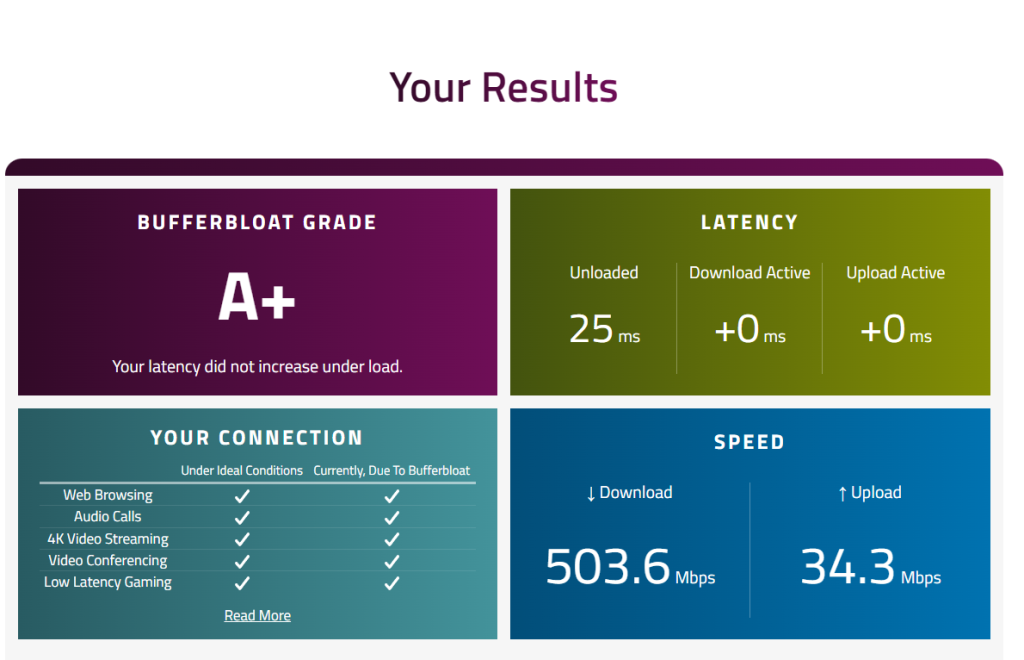

Did you try without any QOS? This is my test. No QOS of any kind.
