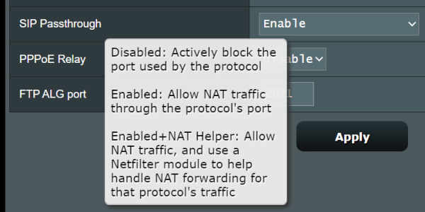

Have you tried changing the setting "SIP Passthrough" on the router's WAN - NAT Passthrough page?
Thank you for your reply Colin.
Is that not the setting to enable sip alg?
The pbx mentions to make sure alg is turned off.
I will give it a go
Sorry, I don't know much about SIP. I've read that generally it's recommended that setting is turned on for stock Asus firmware (maybe that advice has changed), but I didn't know what your router was set to.
Alternatively you could try using Merlin's firmware as that has an additional SIP passthrough option.
