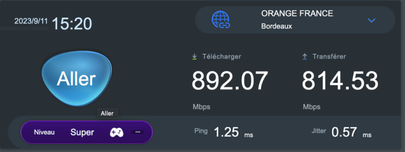

Hello everyone,
I'm asking for your help in understanding the problem I'm having with my RT-ax86s.
I use this router mainly to play online games on my PS5. Since getting this router, I've been experiencing latency. For example, in fps type shooting games, I have a lack of fluidity making the character slow. The connection is stable though, with connection speeds that are more than appreciable.
Yesterday, in my desperation, I put the finishing touches to this forum in the hope of finding a solution to my problem. My asus router is connected behind the modem of my ISP in router mode, the DMZ has been activated with the IP of the asus router. I then deactivated the DHCP of my ISP and the magic began to work, during my game session, for the first time in 1 year I had a hyper fluid game without delay. Unfortunately this did not last, I have the impression that there is a network conflict between my ISP and the asus router. As a novice with the knowledge of a 3 year old in this field, I would like to know what is wrong with my configuration.
Thanks in advance
Your question has no answer. The speedtest shown is excellent. Multiple factors may affect online gaming.
