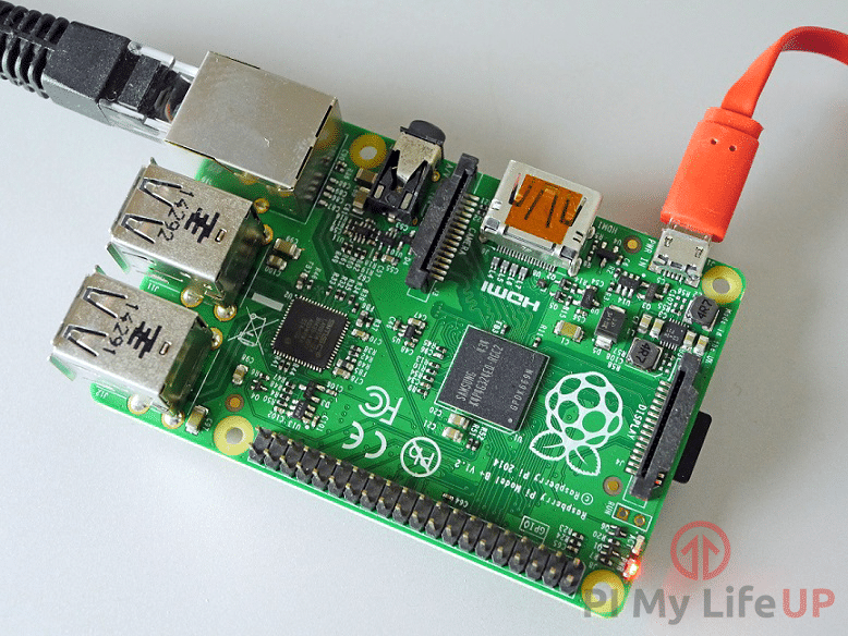

Second approach, would it be possible to run a captive portal software externally (on a Raspberry PI or a PC server) and redirect some users to this from Asus router ?

I know, there are many sources which explain how to build a captive portal on a raspberry PI.
But can I redirect specific users from Asus router to that captive portal ?
The above examples of setting up a captive portal on the Pi rely on the Pi being a WiFi access point. You would have your WiFi network clients that you want to access the captive portal connect to that WiFI Pi access point rather than the WiFi of the Asus router.
Or are you asking about routing wired LAN clients to a captive portal?
