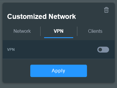

@bennor, as I already commented in another post, the VPN is not configured (for the moment) in the Guest Network Pro profile (to prevent it from interfering).

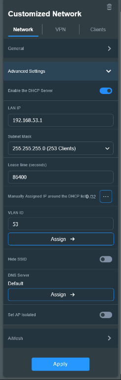

My configuration is very simple:
I have only one Guest Network Pro profile on VLAN 53 (I have tried first with VLAN 52 without success). This profile was created with the Customized Network option, the “Use same subnet as main network” option is disabled and “Access Intranet” is enabled (even though it doesn't work and the option does not appear when creating the profile, only once created).
I don't know if it can affect but in LAN-IPTV I have configured an ISP profile that is necessary for my Internet and TV connection.

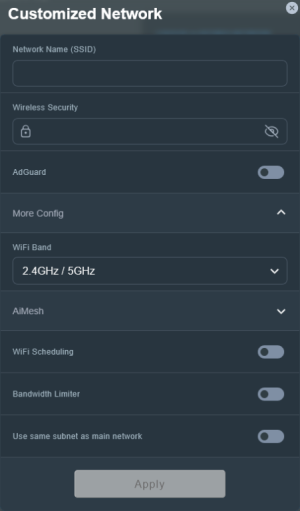

Since it works for you, I would ask you to check if when you create a Customized Network profile the Access Intranet option appears, since it does not appear for me, only when the profile is created.
This is the first firmware version of the 3006 branch for this router and I can't determine if in any other previous version that option appeared.

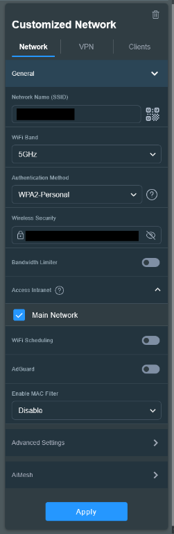

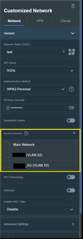

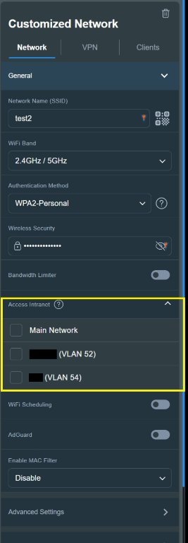

The brctl show results look OK (similar to what I see on a RT-AX86U Pro).
Attached are two examples showing Customized Network profile with the Access Intranet option. In the past some of us have found that Guest Network Pro gets a bit wonky if we've added and removed a number of Profiles. Like the firmware gets confused and incorrectly displays the options for a Profile. What you may have to do is deleted all existing Guest Network Profiles then reboot the router. Give the router 5 to 10 minutes to settle down after reboot, then try adding in a new Guest Network Pro Profile and see if the missing options show up.
My current setup uses the IoT Guest Network Profile. I also have the WiFi Bands option set to a single WiFi band, not to 2.4 GHz/5 GHz.
