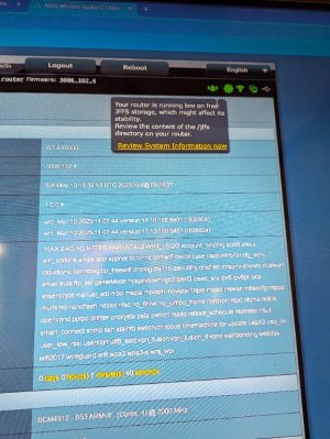

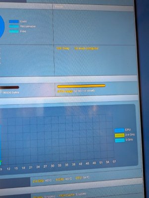

Hi i installed this merlin firmware for the first time over my old stock Asus firmware and I noticed in the new merlin webpage it has this little flashing notification icon telling me the jffs storage is full. How do I fix that ? I tried factory reset and it was still full but when going back to the original Asus firmware the icon is then gone. Is this a bug. I'm new to this. I'm using the ax6000. I did manage to mod my German device to USA channels and higher power output though.
doesnt any 1 else get this to?

When you factory reset, did you thick the "initialize" box next to the reset button in gui?
Resetting didn't fix the jffs issue. The storage is still full. I think it's bugged. I tried uploading the backup jffs and it's 2mb and restoring it doesn nothing to. Also can't connect to the internet when I reset lol not sure why I'm entering the correct ppoe details.
After resetting with "initialize" thicket, you configure your router manually from scratch, and NOT uploading any sort of config backup files ?
You can also try unplugging all cables from the router for 10 minutes (leave the on switch on the router to "on" while it's unplugged).
Edit: you might wan't to read this thread also (similar problems): https://www.snbforums.com/threads/factory-and-hard-reset-low-on-free-jffs-storage-gt-ax6000.91194/
ok i fixed it. i did a rescue to the 388.7 rog merlin firmware and did a reset and have my jffs back to low but then my router acts weird as in when i update it seems to fail. i was able to get latest asus update to work but not the latest merlin. it fails to upload and it doesnt work with rescure using that firmware either. not sure why i had the latest merlin on the router in the morning. this router is buggy as hell lol. i think ill just leave latest stock asus fw on here since it seems like the jffs is still low/empty because my smart features are working. i think it might be the merlin firmware which caused all the issues to begin with tho lol.
