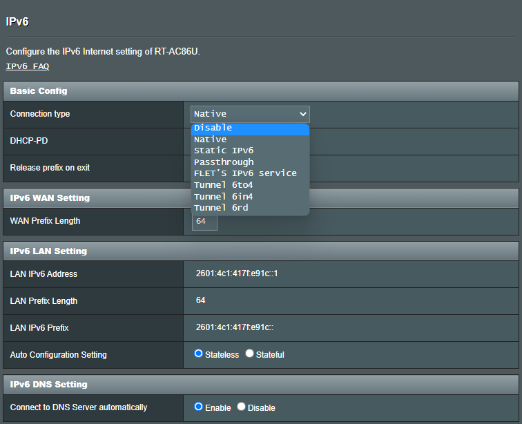

A little off-topic, but would anyone happen to know what NVRAM variable keeps track of this "Connection Type" dropdown under the IPv6 section of the UI?
