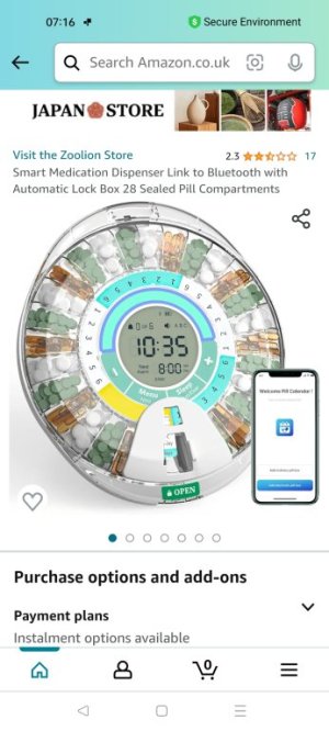

I fancy one of these would be more up our street
