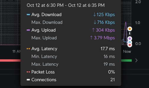

Everything has been running great with the new setup, but now Im getting on the front of the Max- contact your ISP, strange my modem is online( running bridge mode), I connect my GT-AX6000 back up and I have internet. Its when trying to use the unifi Max I get an error, tired rebooting it still the same issues
Anyone else got this error before
Was it working before? In Settings, Internet there is Auto/Custom WAN monitoring. It may advice to reboot the modem or contact the ISP on detected DNS issues, high latency, packet loss, etc. Auto setting is quite sensitive and may trigger warnings on residential ISP lines.

Yes it has been working for well over 3 weeks now, just getting this error now, right now I have it set for auto, but using ControlD in the CyberSecure settings.
I have been away from the house- I called my ISP provider asked then if they could reboot the modem for me but they could not ping the modem- I had to get someone go into the house and reboot the rogers modem and Unifi Max......Everythign is working again

I'm also on Rogers Cable network. It happened few times in the past the modem had to be rebooted after network maintenance.
You can't manually reboot your modem? That is the only thing I am able to do with comcrap taking over my s33.
Can't do it remotely when the modem has no connection.
I have a device (now discontinued) called UniFi Smart Power Plug. It reboots the modem automatically when WAN monitoring reports no ISP connection. There are similar devices from other manufacturers doing the same. One example below.
