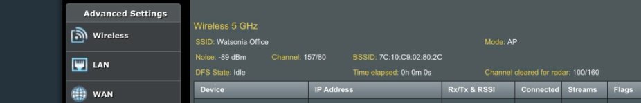

I use channel 100 with 160mhz width. I’m 7 miles from a major international airport with a weather read station (KDTW). My pixel 6 connects at 160mhz and can use all of my 600mb service at times. Experiment and see what actually works for you
