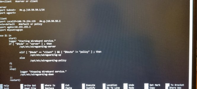

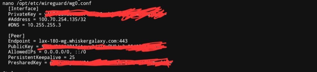

manually running S50wireguard starts your client and is useable? Can you post the contents of that file? Entware start up files must be in a specific format. If it is not, then the calling system likely does not know what to do with it.
This 2 files only

If the script is working when called manually, then I suspect Entware is trying to call the script too early. The WAN is not up yet. Back when I setting a wg client to a VM, I had the same issue. Even called from services-start, it was trying to start too early. I ended up having to move the script to wan-event and have it start only on a "connected" event.
You can test this. Put a line something like
echo "wg client script tried to run" > /tmp/wg_client.txt
Reboot the router and see if the file wg_client.txt exist.
If the file exists, then it tells me that the script tried to run, but too early.

Hmmm. So, when you start the script manually; i.e. ./S50wireguard start, your client starts and you can use it. But it is not starting when entware starts it on a bootup (as you don't see the dbug file created). That is weird.
There is a logger statement in the script. Do you see the script trying to start in the syslog?
The only thing I can suggest, as I stated above, the WAN has to be up before the client will start. I suggest you create a /jffs/scripts/wan-event script and add the following;

replacing /path/to/wireguard_client_script with the path to the script that starts your client (S50wireguard). I would move it out of the init.d directory as it is clearly not doing anything there.
Unless I am missing something, that is about all I can help you with. I still think you may be better off installing wireguard_manager from amtm and setup your client that way.

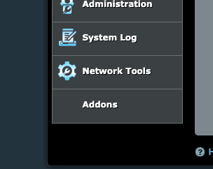

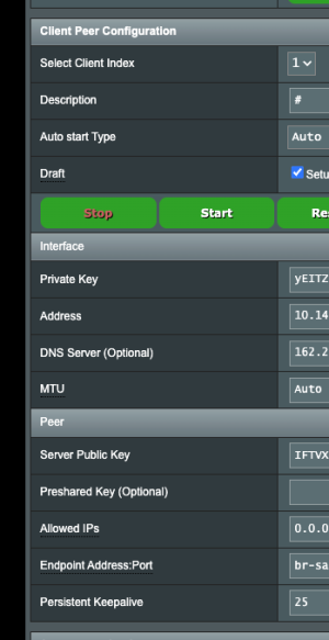

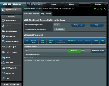

How can you configure it from the GUI?
Also, would you mind sharing your bash scripts?
You can't on the 386 code base.
the only thing I added was through SSH the config file that has this data (Private Key, Address, DNS....) at the specific folder. The client was recognized at the Wireguard Manager and I started it. I noticed it was working because I had OPENVPN cofigured and it showed *error connecting* but I had a connection and a Brazilian IP (due to the server I configured Wireguard)
Let me know if I can help you with anything more specific!
