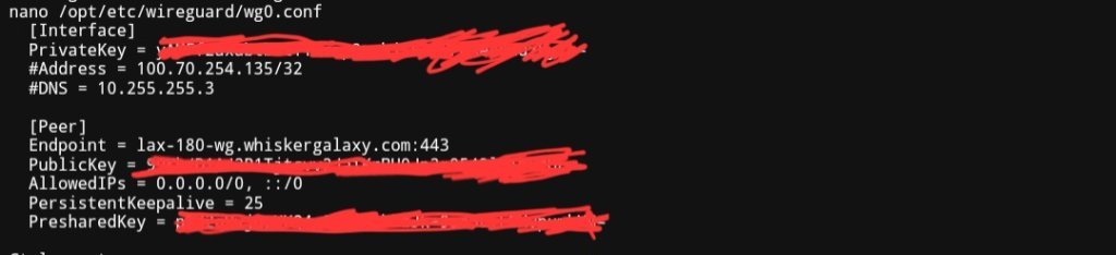

You mean this one startup script?
That is your conf file, I mean the script to actually start your wg interface.
If you have entware installed, you might be better off just installing wireguard-manager via AMTM and up your client that way.
