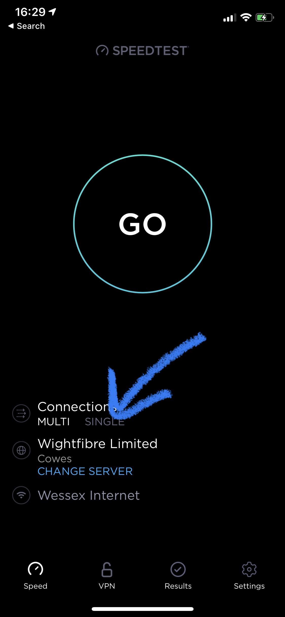

Loadbalancing doesn’t bond the 2 uplinks speeds.
It means each individual TCP/UDP connection is either VDSL or 4G - so if you do a load of single thread download tests with 50:50 loadbalancing, roughly half will get VDSL speed and the other half 4G.
The confusing thing is most speed tests sites do a multi connection test (which may use both uplinks) and average the result so giving you an incorrect representation of what a normal download will get. See speed test app option;
0f2df1b9e1f9924a00aed4650eef158f.plist
There is no “main ip”, you have 2 IP’s, one for each uplink and can’t change that. Which one is used per connection follows the rules above.
