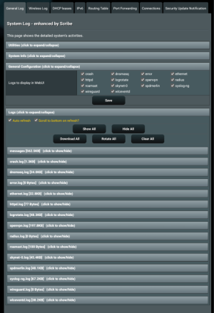

Once you have created the configuration file and placed it in the "/opt/etc/syslog-ng.d" directory, go to the Scribe CLI menu and select to restart syslog-ng ('rs' option). Then go to "su) scribe utilities" menu and select the "lc) Show loaded syslog-ng config" option to double-check that your new filtering configuration is now listed there.
For uiScribe to show the new filtered log file, go to the uiScribe CLI menu and select the "1) Customise list of logs displayed by uiScribe" option to make sure the new filtered log file is included.
HTH
