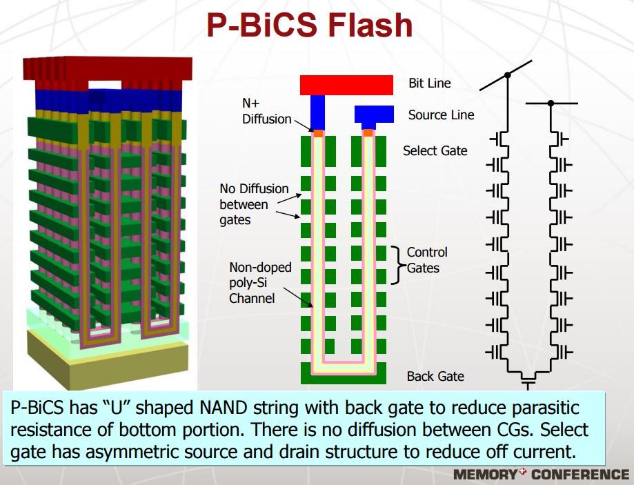

If you look closely at Post #8 Toshiba BiCS3 is a good quality, just an older generation.
