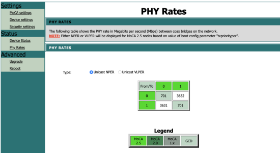

Which one of the PHY rate tables is current ?
i would replace the non moca splitter.
These are the PHY rates just before I replied to this post. I thought the docking station was part of the issue. I took my docking station down to the GFiber, plugged in the fiber router, and got 2.35G on both the download and upload speeds. So, something is passing through one of the MoCA adapters that is interfering with the download speed. Does it help to put a 2.5G/10G switch with PoE in between the GFiber router and 1st MoCA adapter and do the same thing by installing another 2.5G/10G switch with PoE between the 2nd MoCA adapter and docking station?
