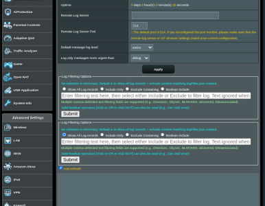

So after updating to new alpha build 3006.102.7
nothing is showing in log and i have dupliated modsyslog

hi,
Thanks for providing this info. Unfortunately I haven't tested with the 3006.102.7 alpha build and probably won't test the script against it until the Beta build is out.
I will reply back to this thread with any updates if needed tho, so stay tuned.
None of the Web UI changed in the alpha, so it’s probably not specific to the alpha. How do you prevent Mod_Syslog_Asp() from running more than once? Do you check if the mod was already applied before applying it?
@Ravenbak - I don't want to assume, but what does "have duplicated modsyslog" mean >> does it mean 2 copies of the modsyslogui script in the /jffs/addons/modsyslogui directory?
@dave14305 - thanks for the questions, they have me rethinking the install () and update () functions to avoid duplicating updates in Mod_Syslog_Asp() and/or not applying the latest updates.
Once I hear back from @Ravenbak, and if the v1.0.1 update works on 3004.388, I will work in pushing out a v1.0.2 update
@kstamand I already update to v1.0.1 and it's working fine on 3006.102.7 alpha1
I already update to v1.0.1 and is working fine with 3006.102.7 alpha1
Can second this. My update above was on 3006.102.7 alpha1.
