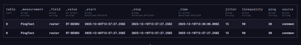

@scootertramp,
Well, as mentioned earlier, I was very curious about how InfluxDB handles "data tags" vs "data fields" so I took a closer (but not an exhaustive) look this evening, and it turns out that a proper InfluxDB database for connmon ping test results should store the actual data as "fields" not "tags" because you can make proper database queries *and* perform numerical operations/comparisons with "field values" but not with "tag values." That's also part of the reason why "data fields" are required by InfluxDB, but "data tags" are only optional.
IOW, if ping test results are stored as "data fields," you could, for example, make a database query to extract data that is greater/lower than some specific threshold (i.e. "Ping Average values greater than 20 sec." or "Line Quality values lower than 90%."). These kinds of queries are not possible when stored as "data tags."
Here are some screenshots of the relevant info taken from the following docs:
Given the above info, I strongly believe I should modify the way connmon currently sends data points to InfluxDB, which means that you will have to modify your own database queries to properly extract and display the data fields (and tags).
I'll make the code changes tomorrow evening unless a valid, reasonable, and logical argument is presented against making the changes.
@scootertramp,

v3.0.10 on RT-BE88U
[Branch: develop]
HELP [v3.0.10_25121222]
Thanks much.
Looks like this new structure will work even though it shows strange in the InfluxDB WebUI.
I need to spent some time learning FLUX query.
From a simple API call it looks good. (select * from PingTest)
i@rp5-util03:~ $ ./pingtest-query
name,tags,time,Jitter,LineQuality,PingAvrg,PingServer,Router,Source
PingTest,,1765615665000000000,15,90,30,8.8.8.8,RT-BE88U,connmon

Sample screenshots:
Nice improvement.
