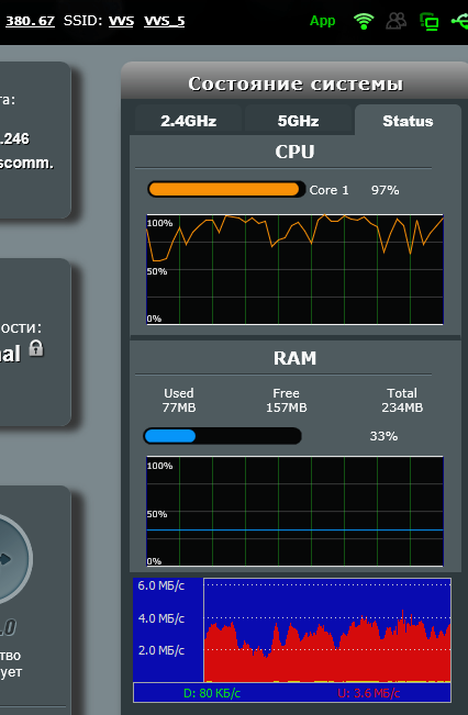

I can attach a couple of screenshots for comparison:
View attachment 10170 View attachment 10171

If you ask me both of those are high your comparing 84% to 97%.
With firmware 380.65_4, the download speed is approximately 9 Mb/s - the processor load is approximately 85%
With firmware 380.67, the download speed is less than 4 Mb/s - the processor load is approximately 97%
