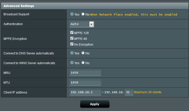

Hi Yorgi, I have tried both of your suggestions with no luck in afraid.
Is this bit correct? I don't understand what the IP address range is for.

I don't think you have to open a port for it to work.
