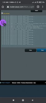

@Jack Yaz
With latest merlin 386.2_2 , chrony showing restarting again & again
With uninstall & install didn't solve the issue
@Jack Yaz
Chronyd working fine here with 386.2_2, so I doubt it's caused by the firmware upgrade.
Can you post your chrony.conf?
You can check conf in above post, i tried with fresh conf file but to no benefit
Issue persists with 386.2_2 for chrony
