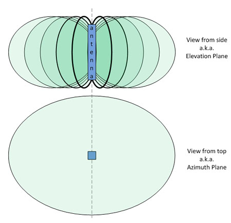

I would say consider how your antennas are placed. people generally want to put them in a Y shape, but that is generally not a very good setup. Think of the antenna as doughnuts. if they are pointed straight up the hole of the doughnut would be the space right above/below the antenna itself, not going to get the best coverage there but as you go out it broadens. now in a straight line from where the line of the antenna is is the best coverage from that antenna. I suggest having at least 1 & at most half of your antennas pointed straight up&down. the others should be adjusted with slight variations from up&down to reach areas that have problems being covered. If you have 1 spot that doesn't get coverage think about where that place is from your router, adjust one of the antennas to have the flat side pointing towards that spot. That will give you the best coverage. The same for the access point.
Now some things like metal pipes can cause some bending of the signals as well, so a good practice is to test, make small changes & test again until you find something that works well for you.
