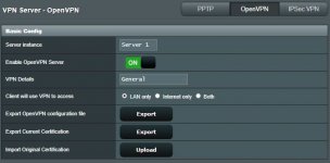

I have an Asus router RT-AX68U with the merlin firmware. That is my OpenVPN Server. Configuration see at the attachments.
