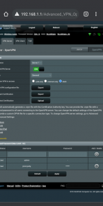

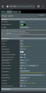

I just realized that when I I have VPN on, I can't access internet. It only allows local traffic.
I have Marlin 384.xx and it is set to VPN Access - Both.
I wasn't able to access all clients on local area until you asked me to manually add the route in the custom config. Is there something I can type in the config to allow internet for the clients?
See attached pics.
