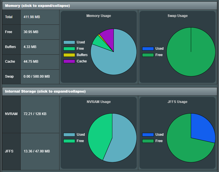

I discovered something over the last week that I think might solve the out of memory issues. My memory was slowly decreasing on my mesh network over time and I began to wonder what the cause was. I believe it`s caused by bufferbloat. What I did was to go into QOS and in the CAKE QOS I made sure it was setup for VDSL2 and PPOE. I then logged out and did a bufferbloat test and found it to be failing. So back into router and this time I went into CAKE and unchecked the automatic bandwidth setting. I followed the 95% of max bandwidth and stated tuning download and upstream values. Over a couple of days I got everything dialed and finally got an A+ rating for bufferbloat. What I noticed after that over a couple of days, my memory usage actually went down and now it is stable at about 55-60%. When I turn QOS of, it starts to creep up like it did before. I would try this for dsl, and fiber to see if this solves out of memory with your router. This was an eye opener.
Odd thing is I had this same setup on an AC56U and it worked fine, and also on this AX68U on prior firmware, it never used the swap file before.
I enabled the swap file again just so it can keep working if it needs it, removed those two scripts you suggested.
Memory looks about the same with those two removed and rebooting but maybe not running the speed test will help. I did have the speed test only running once a day, I think the default was much more often. I will keep an eye on it and see if it starts swapping again.
Also, NVRAM and JFFS has always had plenty of free space, so I assume all the errors are related to RAM even though it is complaining about writing files.

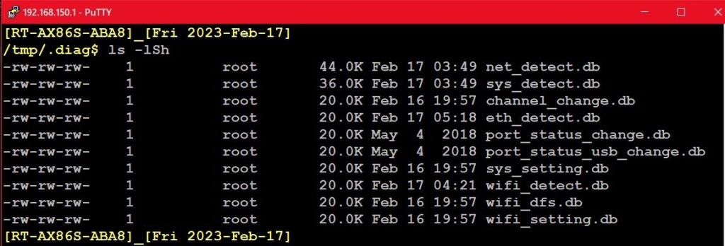

Yeah, it seems that the set of *.db files is not going to be always the same in all routers, and apparently not all *.db files will exist on the same router all the time. I don't know what determines when or which specific *.db file gets created and under what circumstances.
For example, the following screenshot shows the current DB files on an RT-AX86S router:
Notice that it doesn't have the "stainfo.db" and "stainfo_stable.db" files that other users have shown, but it does have a "port_status_usb_change.db" file that others don't have.
BTW, since my cousin's RT-AX86S router was having the same problem with some *.db files getting too big, I took your original script (thank you for that) and made several changes so that it finds only the *.db files that actually exist in the "/tmp/.diag" folder, and then it checks for file size larger than 64KB; when found, it goes ahead and does the trimming of the DB file for data that's older than 30 minutes. This configuration is working well for my cousin's use case (he's running the script every hour as a cron job - no need to run it more often). The modified script also reports the file size just before and right after the trimming process; in addition, it creates a log file of all the results in the "/tmp/var/tmp" folder. If you manually run the script from its location (e.g. cd /jffs/scripts), it will also output the results to the terminal window.
Attached below is a sample log file (CleanDBFiles.log.txt) from an early run of the script.
If you're interested in taking a look at the modified version of the script, it's available in PasteBin:

I've been keeping an eye on this thread as I was getting sporadic reboots on my AX86S running 388.1, I went back to 386_7.2 in the end.
I've recently loaded the latest beta - 388.2_beta1, The router runs with about 32MB free mem, it has a 2Gb swap file but I've never seen it used.
It's been running for a couple of days now without problems, but I've just noticed that the files in /tmp/.diag seem to have some kind of garbage collection going on.
I don't know if it's size-based or a regular job but stainfo.db, for example, seems to grow to around 1600000 before getting chopped down to around 800000.

I have same/SIMILAR issue, do you run AGH?
No, I have very few add-ons: YazDHCP, scMerlin, mosquitto, openssh-sftp-server
