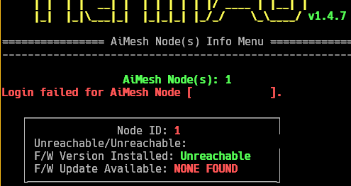

I remember implementing that... The trick is lots of blood, sweat, and tears. :D
Can confirm these NVRAM keys are accurate.
If I remember correctly; the way we use the keys is cfg_device_list more "dynamic" and as nodes come online and offline those values should update within a reasonable time-frame.
While asus_device_list is more of a permanent list of all "paired" devices whether they are reachable or not at that time.
P.S. off-topic, but @ExtremeFiretop 's MerlinAU script on one of my networks picked up RT-AC66 (original, not B1)with latest patches from-dont-remmember-fork and :
so beware before reusing code! 😁
