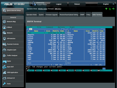

After extensive testing and refinement, I am pleased to introduce Idefix Terminal—a browser-based console now available under Administration ā–ø Idefix Terminal in your router’s web interface.

A real BusyBox/ash shell with colour, UTF-8 and scroll-back – no more juggling PuTTY. Works from any device: phone, tablet, even your TV’s browser.
