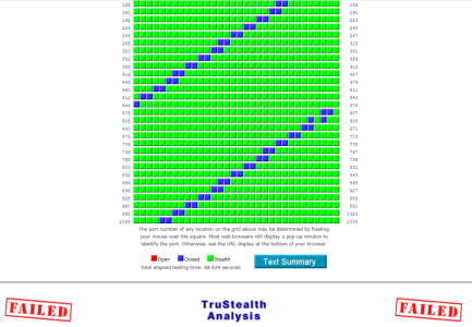

I was curious to know why the FRITZ!Box 7530 AX router supplied by my ISP (which I'm keeping as a backup) failed the GRC ShieldsUP! port-scan test, while my RT-AX88U Pro passes the test.
I did receive a reply today from my ISP (Zen Internet), but it's in technical language, which I don't fully understand, so I was wondering if someone could offer me a simple summary of what it means?
This is the message I received and the attachement I am uploading shows the result of the port-scan test.

I did follow the suggested procedure to set the firewall to stealth mode when I first got the FRITZ!Box, but even so, port 113 still remained as closed, rather than stealthed. Also, I'd forgotten that I had followed that procedure and when I reverted back from the latest beta firmware (which they call "Lab") once Wireguard became available on the latest official firmware. Doing so required the router to be reset to factory defaults, which I now know is why I lost the firewall stealth settings that I had previously enabled (my memory is quite flaky at times nowadays nd probably age-related).
It simply means FritzBox leave some ports closed, not stealthed , while ASUS stealth the ports.
There is no problem the ports are blue/closed which is all that matters.
GRC.com and its owner have this notion that having ports stealthed makes you more secure or invisible to hackers , they are wrong.
Don't worry about it.

Thanks Merlin. But wouldn't I therefore expect to see the same results with my ASUS router if that were the case? (excuse my ignorance here)

I'll bear that in mind if I do need to use the AVM router. I may just apply the stealthed setting sooner rather than later though, in case I forget what I've just been told. Thank you for the explanation - much appreciated.
That's correct. In that case it might just be some different behaviour on the Fritzbox, which sound odd to me.
Ultimately it does not matter. Whether it's dropped (ignored) or rejected (with a RST packet sent back), the end result is the same.

In reality I've yet to see a site that requires you to respond in that fashion as a security measure. All my ports are stealthed and never any problems. Your ISP may have implemented it for one particular site or service, maybe many years ago, and has just kept it in there.
From a security perspective, it does not open you up to anything, but generally stealth is better than reject (reset) since if someone is scanning for active IPs, yours may reply (depending what ports they're scanning). Even though it is a reject/reset, it tells them the IP is active and maybe a potential target.
I'd compare this to the feature in most routers to "allow ping on WAN IP". Most disable that so they won't get picked up by ping scans and become a potential target. It does not make you more secure per se, just helps keep you off the radar. Also reduces the attack surface for a DOS/DDOS attack but pretty rare for a home user to be subject to that, unless you piss off a group of people in IRC etc, in which case you just need to force a new WAN IP.
If their box gives you the option to disable that "feature" I'd do it if you ever need to use it, but if not, I wouldn't worry about it.
