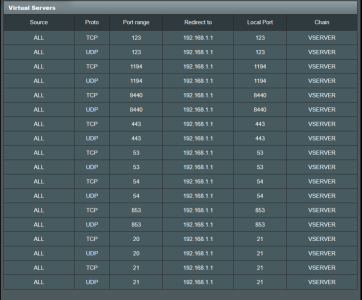

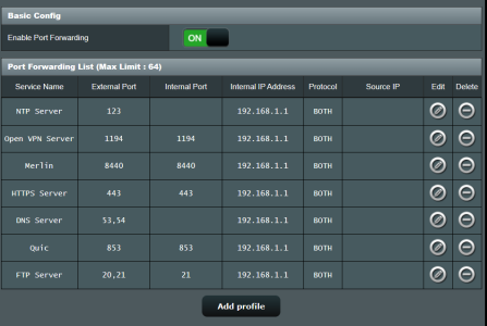

Anyway once all is setup, I'm chuffed that all is going to plan and I do not have any problems anymore! I opened ports 443 and 853 on the router and disabled the firewall and checked that I can access my adguard home server outside the home network. All is going to plan. Until...
A few days ago, I wanted to try Skynet Firewall, installed it for a few hours, did not really think it would be useful for my needs and uninstalled it. Since then I'm unable to access the adguard home web interface from outside the home network. Checked the firewall, it was re-enabled by skynet, disabled it and yet my problem isn't solved.
What is interesting is that, when I change set_http3 in the adguard home yaml file to 'true' I'm able to access my home DNS server using a h3:// address but I still can't access the https:// web interface. I then went ahead and used the quic protocol and it works perfectly well. Then checked with the TLS protocol and I can't reach my server.
Am I right in thinking - that I'm able to access my server through UDP (h3 over 443 and quic over 853) protocol but not through TCP (https over 443 and tls over 853) ? It seems there is some corroborating evidence as I'm able to reach the VPN server in my router (UDP) but unable to reach FTP (tcp over 20,21), which I previously was able to.
Any help will be greatly appreciated. Attaching screenshots of my port forwarding rules and syslog of port forwarding
P.S. - I have UPnP disabled and firewall disabled. I understand that port forwarding is from the router to a downstream LAN client but even when I input the router's IP address in Internal IP, it works (such as with VPN server and remote access of WebUI)
