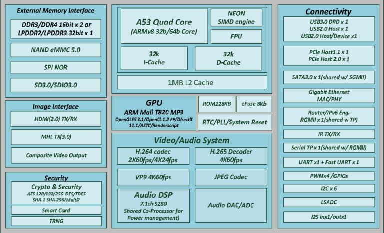

    Buffalo released something recently on Realtek... Found it interesting, as the board layout for Realtek is very similar to Allwinner in the SBC space.... mostly in the SoC to RAM/NAND orientation....
    Nice to see Realtek in this space - most of the ARM's have been Marvell up to now - we've got AnnuPurna Labs (e.g. Amazon) jumping in on the high end, and Realtek on the low-end - let's see what Marvell responds with (and yes, they have a chip there that is pretty impressive).

    The eMMC is from Toshiba.
    Also, the RTD1295 would've been a much better choice, but obviously more costly.

    The SATA is running off the Realtek's USB3.0 port via the ASMedia ASM1153E, which is an odd choice for a NAS... and may explain some of the storage numbers...
    At least there is UASP, which does help out here compared to the Bulk-only Transport profile...
    Info below:
    ASM1153E is the ASMedia third generation single chip solution, bridging the USB3.0 to Serial SATA host interface with highly integrated SuperSpeed USB3.0, High Speed USDB2.0 and SATA1.5/3.0/6.0 Gbps ASMedia self -designed PHYs. Along with excellent compatibility with USB3.0 host and SATA device, ASM1153E uses advanced process technology to optimize the chip power consumption. Furthermore, it is also pit-to-pin backward compatible with existing ASM1053.
    Customers can easily enhance their storage device performance with ASM1153 since it also integrates an 8-bit micro-processor and embedded RAM to provide a cutting edge solution in USB to SATA device enclosure market.
    --Features
    * Compliant with USB3.0 Specification Revision 1.0
    * Compliant with USB Specification Revision 2.0
    * Support USB Super-Speed, High-Speed and Full-Speed Operation
    * Support Mass Storage Class, Bulk-Only Transport Specification Revision 1.3
    * Support USB Attached SCSI Protocol Specification Revision 1.0
    * Compliant with Serial ATA Specification Revision 3.0
    * Serial ATA bus up to 6Gbps Signal bandwidth
    * Support Spread Spectrum Control of USB3.0 and SATA interface to improve the EMI Performance
    * Support ATA/ATAPI Packet Command Set
    * Support ATA/ATAPI LBA48 addressing mode
    * Integrated 8-bit micro-processor with embedded program RAM and ROM
    * Support SPI NVRAM for Vender Specific Application of USB device Controller
    * Support multi-GPIO pins
    * Support programmable PWMs
    * Support 20/25/30MHz with external crystal mode or 30MHz with Clock input mode via strapping
    * Integrated two internal voltage regulator for IO power and Core
    * HBM ESD 2KV and MM ESD 200V
