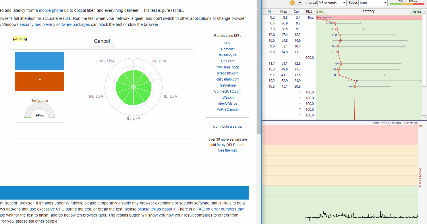

For some reason your game doesn't reflect the dslreport results.
@Weggy have you ran pingplotter yet, pinging google for a longer ammount of time both with QOS on && off, to see a bigger picture?
Irregardless of the results, unless some devices are bypassing QOS metering, you are out of options to improve performance. Maybe try traditional with custom rules?

So FreshJR kindly VNC to my computer to attmept to diagnose this issue. It appears that I get large latency spikes of over 150ms when my network load spikes. Meaning if I have a constant load or saturation, I don't have latency issues. But my Amazon Fire Stick or NetFlix spike my network load, it is not constant. Casuing these large spikes in latency.
How can this be fixed. Right now, he's not sure after trying many different things. But I'm hoping he can come up with a plan :)
Thanks again FreshJR for looking at the issue.
FreshJR, I've discover that 31.55.186.177 is a BT DNS server (BT is my ISP). Meaning that with pingplotter running you can see a very simple representation of how these spikes are effecting latency. What I wanted to ask based off of this was could this be an ISP issue I'm not in control of? Meaning even if my router was configured perfectly, could BT be causing the issue by managing my data?
So just to quell your curiosity.
It takes X ammount of hops, lets say 13, for your packet to get to its desitnation.
Pingplotter pings each of these hops as well as the destination separately and then records the results.
So 1 pingplotter interval is ~13 separate pings.
The data on top shows you the ping deviation and packet loss from each hop.
The chart on the bottom shows total ping and packet loss from the destination.
The only thing to cause concern would be if a hop along the way is experiencing packet loss or high ping deviations. This would mean that particular hop is undergoing some network issues and these stack on the end result.
For example, if you run a pingtest and saw that tje destination has 50% packet loss. If you then ran a traceroute/pingplotter and noticed a particular hop has constant 50% packet loss, then its not an issue with the destination but actually a hop along the way.
The hops in your results had no issues.
(The 50-100% packetloss when pinging the router (1rst hop) itself is nothing to be alarmed about, if that was your original question. The router is simply not responding to the individual ping requests itself since the defined interval is too short and it is treating it as a DDOS attack. Interval needs to be 1sec plus to ping the router.)

Is there a way I can 100% confirm it is either a router issue or an ISP issue?
All ISP's have bufferbloat, its just the natural result of limiting bandwidth.
Some ISP's supply modems with built in QOS mitigation to minimize bloat.
For the ISP's that don't, it is up to the user to find a solution or live with it.

.5 seconds always does that to my pingplotter graphs.
router cant cope for some reason.
0.5second interval data are actual results. You just have more precision due to smaller time scales used.
For example, counter strike 144 tick -> interval .007 sec
Hi-Res: https://s8.postimg.cc/jlu11ynbn/results.gif
Results: https://s8.postimg.cc/ppblln8dx/bufferblaot.png
QOS is working on your router and producing results, so it is NOT a hardware issue.
If you get another Asus router, the results will be the same.
