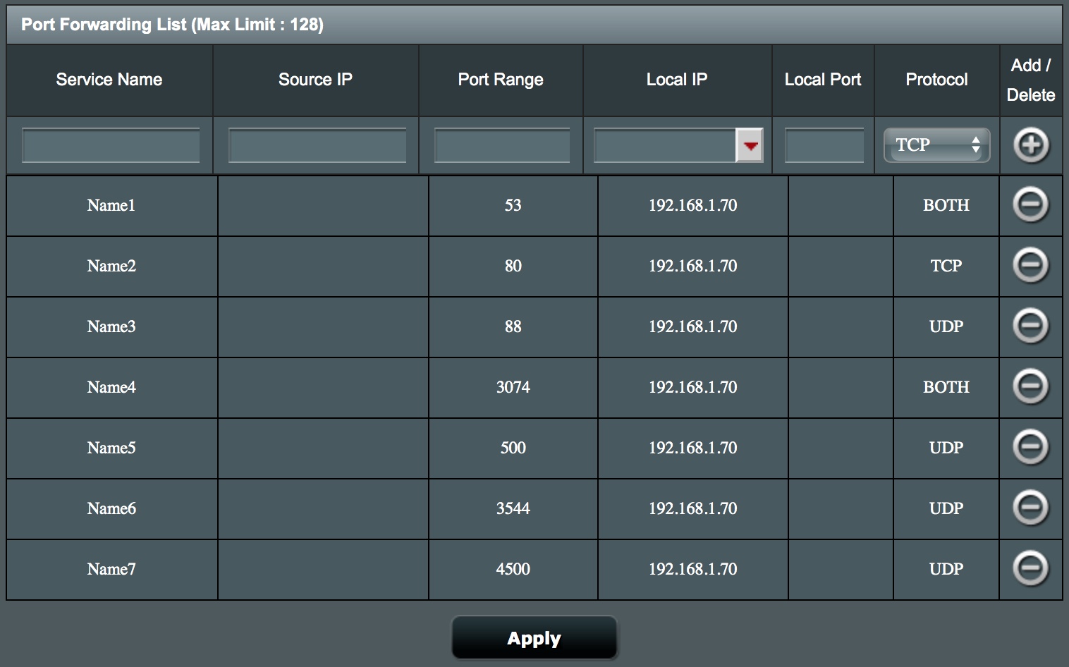

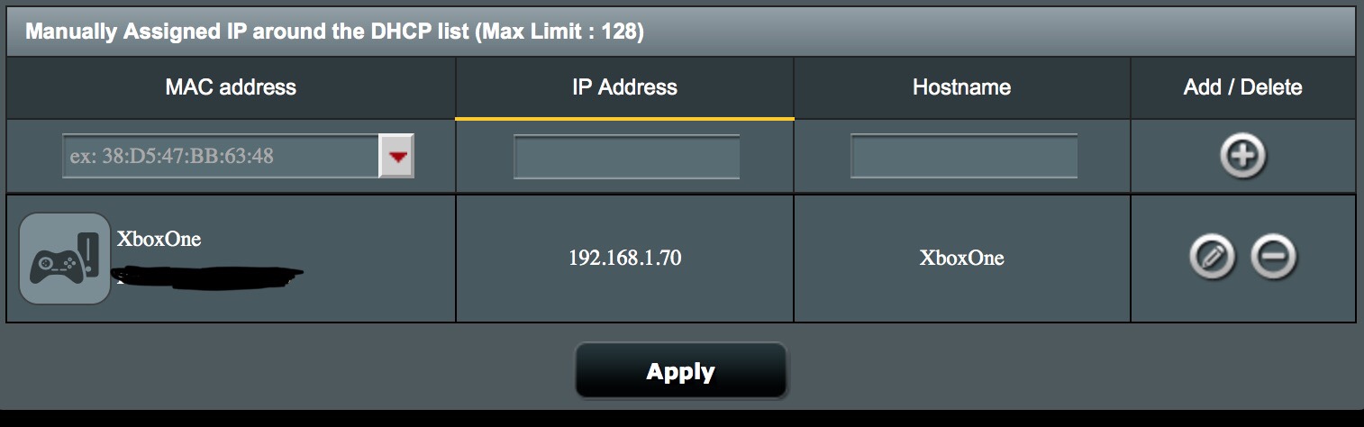

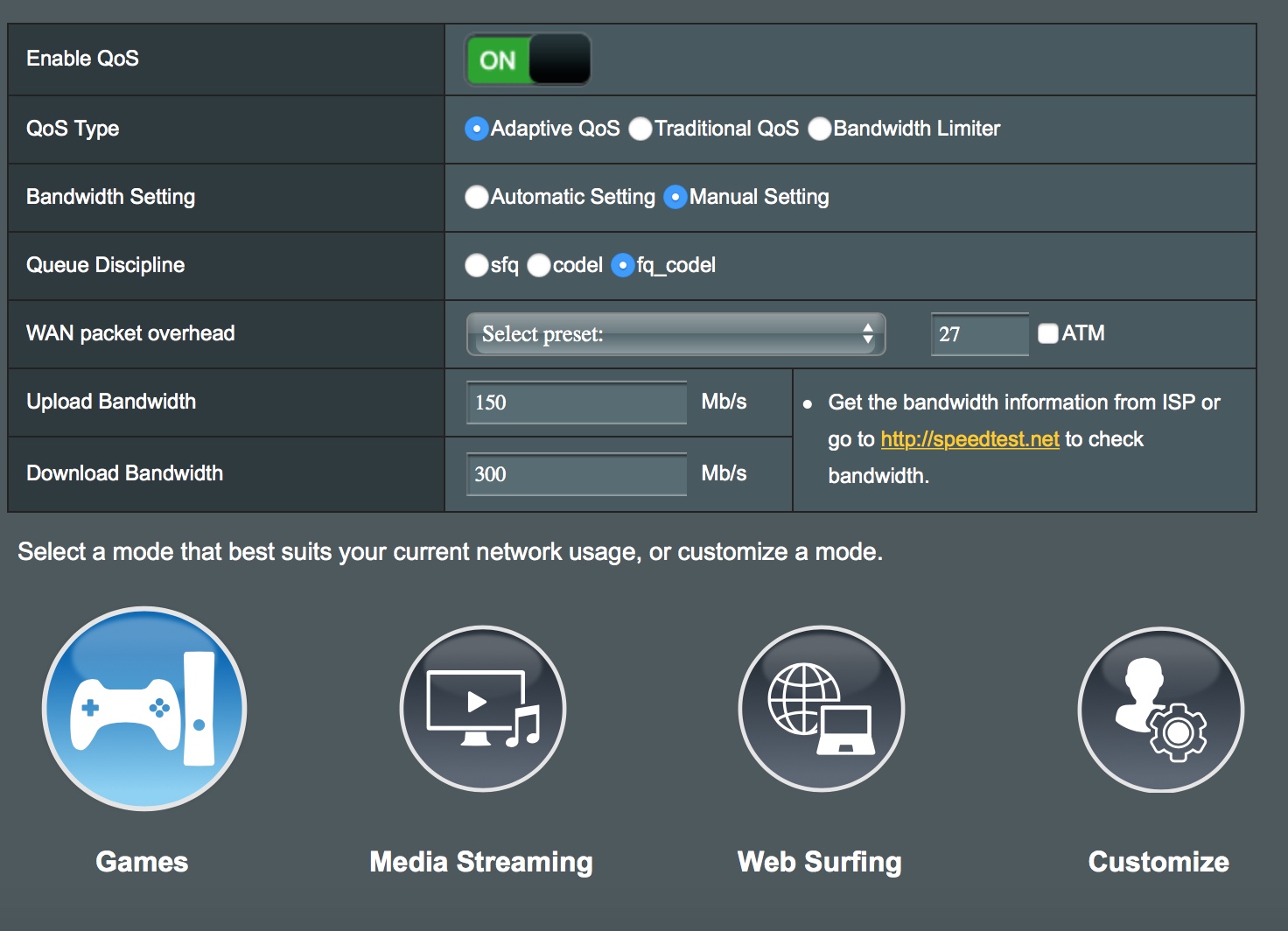

I have done the port forwarding and also tried to use QoS but it's not improved. I'll attach some screenshots of my router settings to see if anyone can help. For example i'm not sure which WAN packet overhead to select for Fibre?

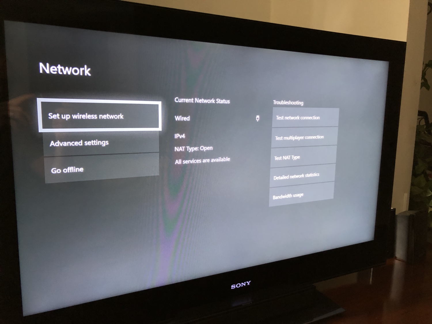

Finally sorted it a different way.
As you’ll see in the attached screenshot above the NAT Type on the HUAWEI Router was Port Restricted Cone NAT.
I changed that to Full Cone NAT as an experiment and voila NAT Open on the XBox.

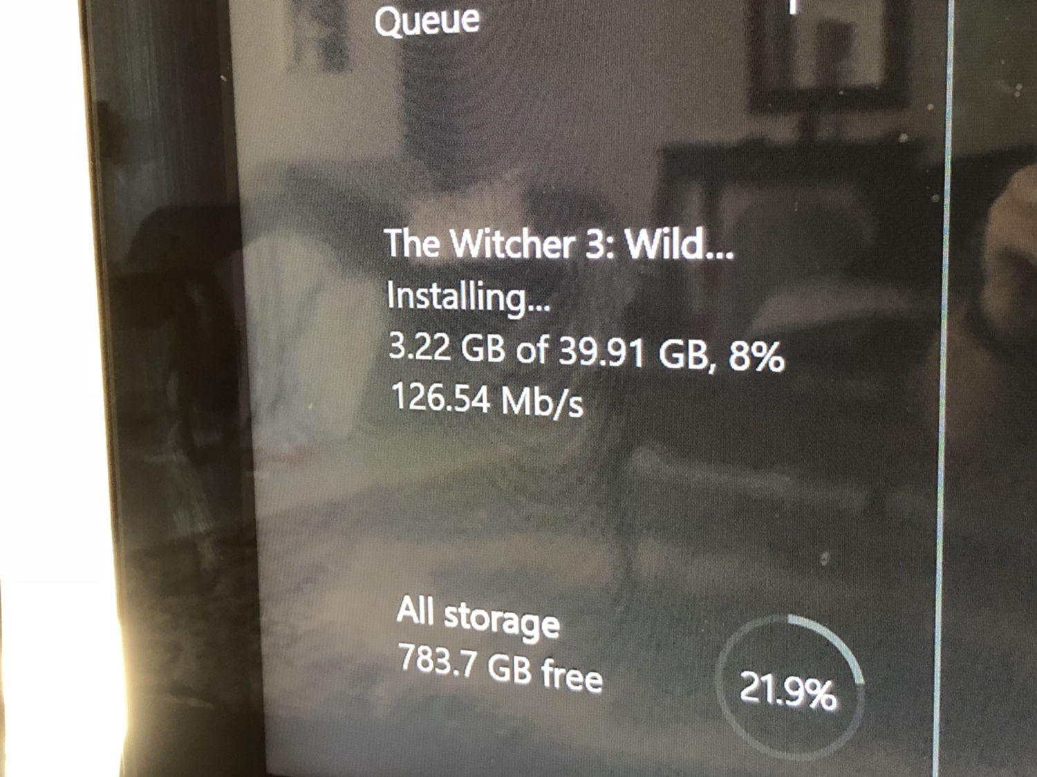

Also the speed is now as so.
So hopefully on Game downloads etc now the speed will improve. If it doesn’t then the issue is Microsoft XBox Live Store side. Thanks for the help. Much appreciated.

With manual QOS configuration NAT hardware acceleration would be disabled. Did you try Adaptive QOS set to gaming and hardware acceleration set to Auto in the LAN settings?
Yes tried that. The speeds are still slow in comparison.

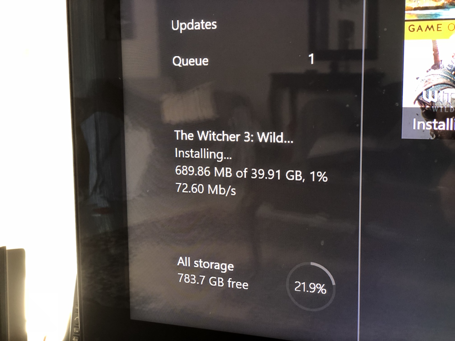

This is the speed it’s fluctuating between when downloading to a SSD (OCZ VERTEX 3) in a USB 3 Caddy.
Every app/game has been quit so the only thing happening on the box is this download.

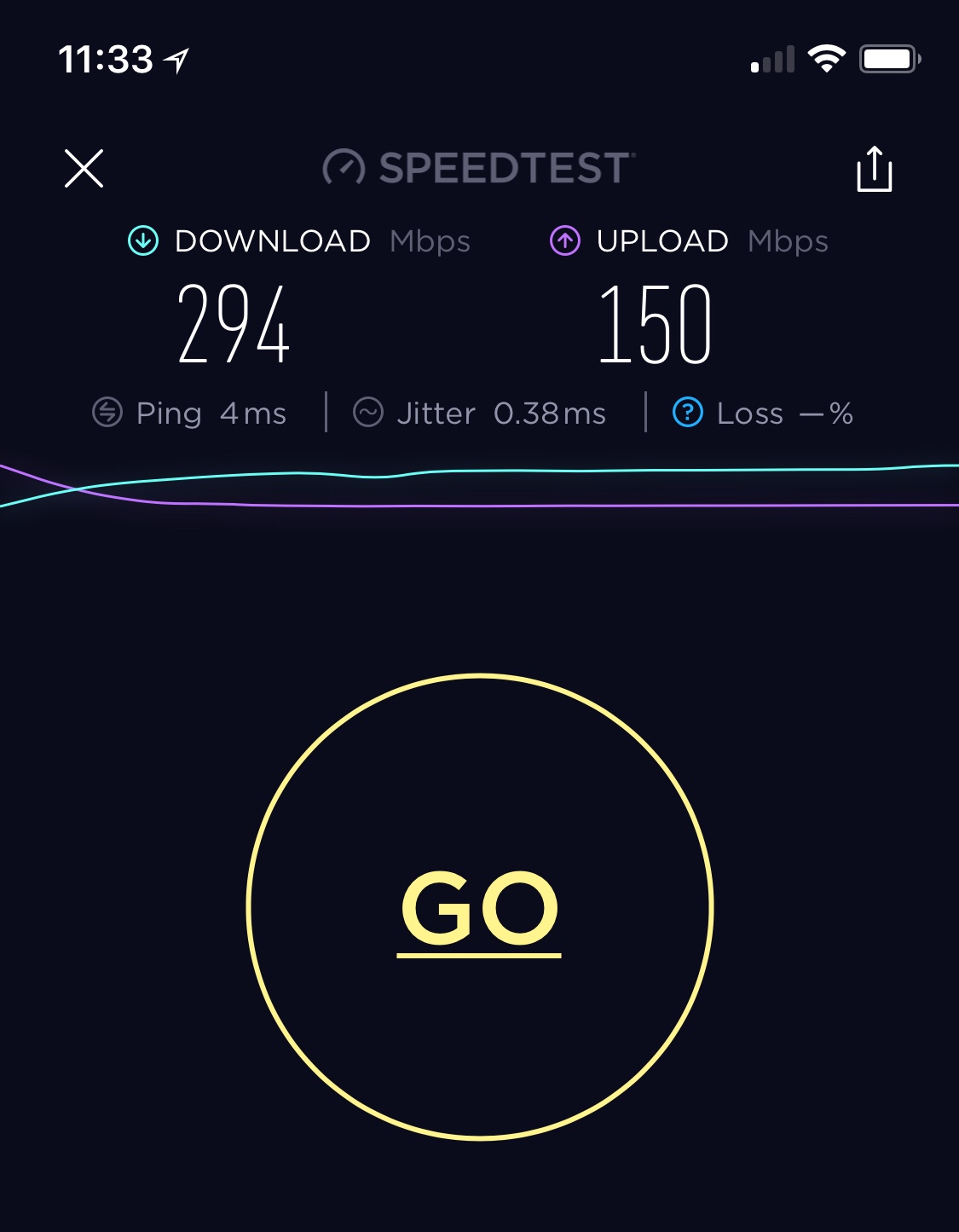

I tested the same drive on my Mac with BlackMagic and it gave a read/write performance of 497/424MBps respectively. So way above anything I can download at. My fibre connection is 300d/150u.
This is my connection speed before I started.
So it must be Microsoft servers (which is surprising given the size of the company).
