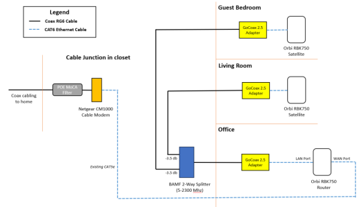

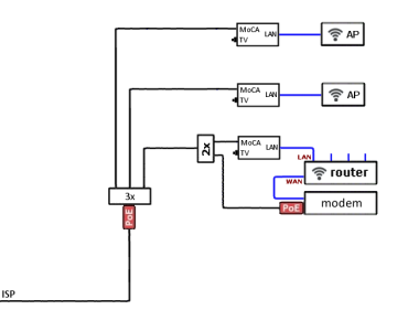

Going off of your post #17 above,
Which includes a diagram explicitly showing how I’d recommend connecting everything, for reasons cited in the bullets at the bottom of this post (including why BAMF splitters aren’t recommended). YMMV.
edit: That said, your diagram should function. I don’t recommend BAMF splitters; I prefer a different topology; and the “PoE” MoCA filter on the isolated modem feed shouldn’t be necessary, and would need to be removed down the road to support higher DOCSIS frequencies.
Got it. I'll go with your suggestion and keep my existing 3-way Amphenol splitter then following your diagram and put the PoE MoCA filter at its input port. Is that a terminator cap on the PoE filter in your diagram?

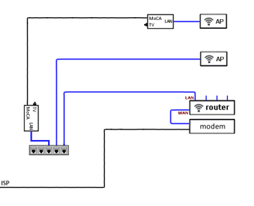

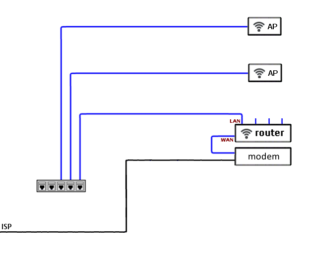

Before abandoning all MoCA connectivity, a quick followup as to what Option 3 could look like with the addition of a single CATx cable between the closet and current modem/router location ... after moving the modem to the closet and establishing a direct connection between it and the ISP, sans filters or splits:
But as mentioned, Option 1-3 are all moot if you get the CATx lines fully reworked for at least the 3 critical rooms.

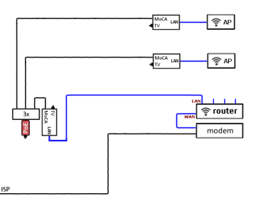

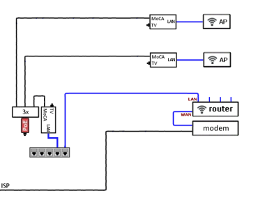

FYI... An alternate approach to Option 3 for when you have that first CATx line between the Closet and Office working ... with probably the least change relative to current, and straying less from the longer-term path leading to all CATx LAN connectivity.
coax WAN + CATx LAN path to closet.pngcoax WAN + CATx LAN path to closet w switch.png
… and once a second CATx line to another room is ready:

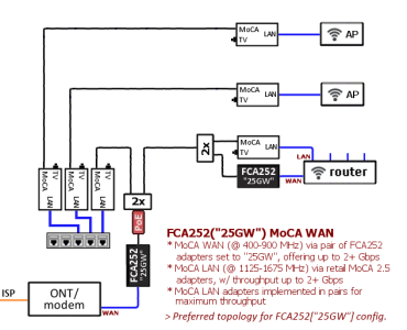

p.s. Attached are add'l diagrams along the way between all coax and a CATx LAN, for comparison.

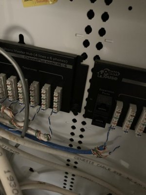

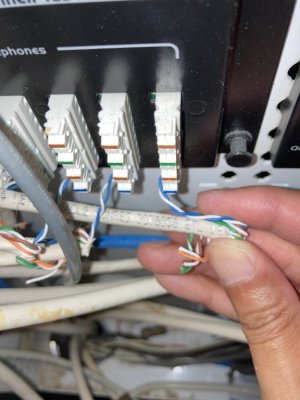

I had a brief moment to take a look at the closet's CAT wiring and behind my office's wall plate (which right now is a coax and RJ11 phone jack combo). In the closet, there are 5 CAT wires that seem to lead to the upstairs rooms and other CAT cables that look to lead downward into my crawlspace. To me, this makes sense given that there are 5 rooms upstairs equipped with phone jacks and a handful of rooms on the first floor that have phone jacks. I'll plan to wire the upstairs in general rather than the downstairs.
On the cables themselves, there is labeling on them albeit faded but I could make out "CAT 5E". Of all of the CAT wires going upstairs and in the crawlspace, there are 2 that have a blue color jacket (the rest are all white) and they look to be regular CAT5 - not CAT5e. Each of these cables are terminated to a removable telephone block panel in the closet and for each CAT cable, I can see a blue/white wire combination terminated (see attached picture).
In my office, I removed the combo wall plate and on the backside of the telephone jack is a series of wires coming out of a CAT5e cable held down by separate screws. I forgot to take a photo of that, but was glad to see that it was a CAT5e cable and not the CAT 5 cable.
My plan is once I receive my Amazon order, I'll re-terminate those CAT5e cables with a RJ45 keystone in the closet and upstairs will replace the phone jacks to RJ45 keystones/wallplates.

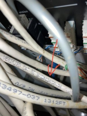

Also beneficial is if you can identify any “MHz” rating within that cable jacket text.
In my office, I … was glad to see that it was a CAT5e cable and not the CAT 5 cable.
Agreed! That’s the most critical line of the bunch.
My plan is … re-terminate those CAT5e cables with a RJ45 keystone in the closet and upstairs will replace the phone jacks to RJ45 keystones/wallplates.
A keystone blank patch panel would be useful in the closet, to hold the keystones in place (protecting the terminations and wiring).
Or... given the pictured structured media cabinet, a 8-port RJ45 data module (examples) similar to the existing telephone modules might make more sense, were it not for cost.
I tried looking for a MHz rating but couldn't make anything definitive out. I attached a few pics of random numbers on the CAT5e cables, but the only other text I could see on the label was "Genesis Cable Systems" and "P/N" followed by a long number which I assume is a part number and "ETL Verified". Hope the pics are helpful...

Do the pics of the cable jacket labels help at all? The labeling is really faded but I can make out the CAT5e part on the white colored cables. The blue colored cables have CAT 5 on the jacket.
If it matters, my home was built circa 2003.
