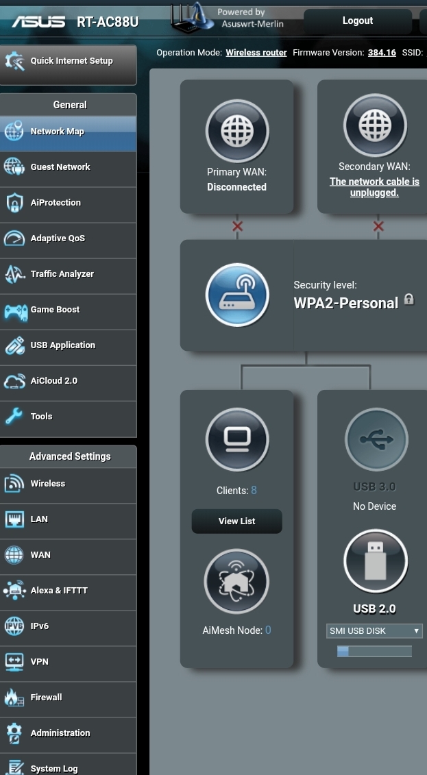

@RMerlin I've noticed since the update that Primary WAN shows as disconnected in WebGUI (but it's up and working just perfect).
It was a dirt update from previous one, and powercycled it but nothing.
-Also on "Security Assessment" it says UPnP is enabled, but on WAN is set as disabled.
-Finally AMTM is unable to check for script updates*
*Could be related to the "Disconnected" on WAN and
Apr  9 20:35:49 miniupnpd[29255]: ioctl(s, SIOCGIFADDR, ...): Cannot assign requested address
Apr  9 20:35:49 miniupnpd[29255]: Failed to get IP for interface eth0
RT-AC88U
Sent from my SM-G965F using Tapatalk
Try power cycling the modem. I've had that before and normally just reboot my cable modem.
Tried it... but didn't help... I think config messed up after upgrading from 384.15 to .16
I'll try a few things more and hard reset if I cannot solve it.

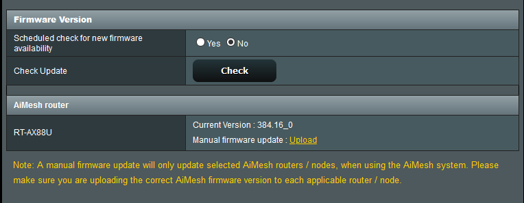

No comments about the ax58u?
I know this thread is about the new firmware but I cannot find any differences between the ax58u & the ax3000 besides the WPA3-Enterprise feature, Do I need that feature? I can get the ax3000 for $159
I'm not even seeing this signature settings on my router from the posted screenshots.
Ah that explains why I don't see it I don't use AiProtection!
On AC56U I always had the option to update the signature even though AiProtection and Adaptive QoS were disabled. But on AC86U it shows up if I enable AiProtection and then disappears if disabled.
They are the same router and share the same firmware.
