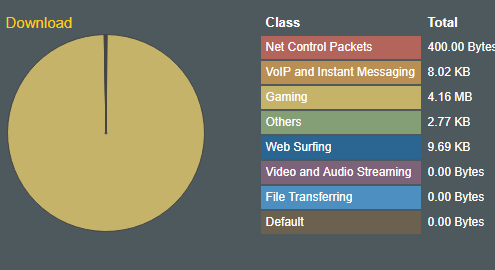

But noticed gaming is very low even though im gaming quite a bit.
Does this mean its in "others"?
What do i have to do to get my games console as ultimate top priority?...or game traffic?

If you turn on apps analasys and see your gaming thruput listed as "general" then yea this is redirecting it into the "others" container.
Not exactally. The gaming rule will redirect "general/unidentified" into gaming instead of others for clients within a specified iprange.
@el pescador Make sure the cidr ip range in the gaming rule matches the dhcp ip assignments of your gaming devices. That rule also has to be enabled by removing the comment. If it is green it is ignored.
All template rules have been thoroughly tested. I just retested the rule to be sure.
But yes, check where the traffic is going via app analysis. Maybe instead of unidentified (general in app analysis) it instead is misidentified as a different type traffic.
If it is misidentified you should be able to create a custom rule for a specific game if it's important to you. There are a lot of templates examples to cobble together a working rule.

Thinking about it though.....maybe its not a bad idea having some gaming traffic (specifically file transfers) being split from normal and others.
atm i put others as top.
i know this may be sharing that spot with other data from other devices.
my dhcp is 192.168.2.1.
console is 192.168.2.165
what line do i have to change?

Line 86, uncomment (delete the # at the beginning of the line) and change the IP from 192.168.1.100/30 to 192.168.2.165/32
And do the same for lines 111-112 (also remove the # from both).
Also, what game(s) are you playing? Can help you with some ports.

I play fifa mainly.
Server based games and the p2p based ones.
That was the idea with the gaming rules I introduced.
"Gaming" Traffic from port 80 or 443 will go into "Downloads".
Usually port 80/443 is not actual "Gaming" traffic but rather "Game downloads & patches"
Just observe it via app analysis first.
There's a good chance it's either already identified as gaming or unidentifed and now redirected to gaming.
Why introduce duplicate rules.
A rule filtering on the port range listed for the PS4 version of FIFA would also end up ignoring the gaming traffic on 80/443 -> "download" redirect rules.
This is because console downloads also occur on those listed ports so theFIFA port rule would also be triggered first by any console downloads, reducing gaming QOS effectiveness.
Less is really more.
